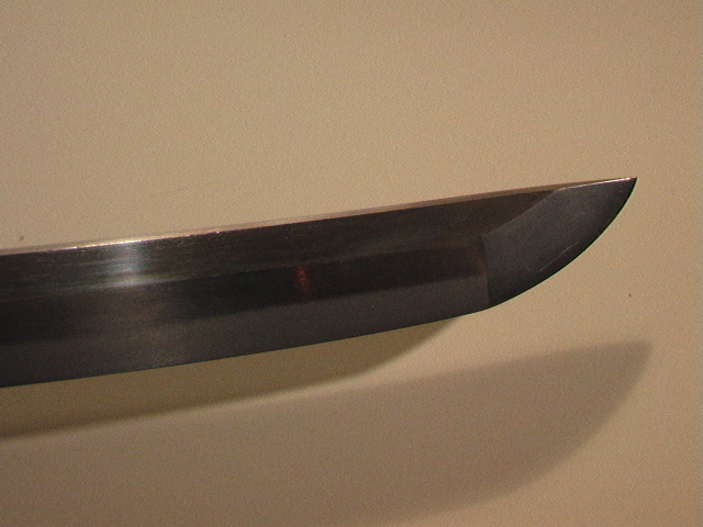

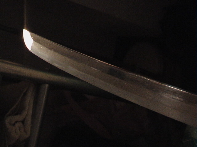

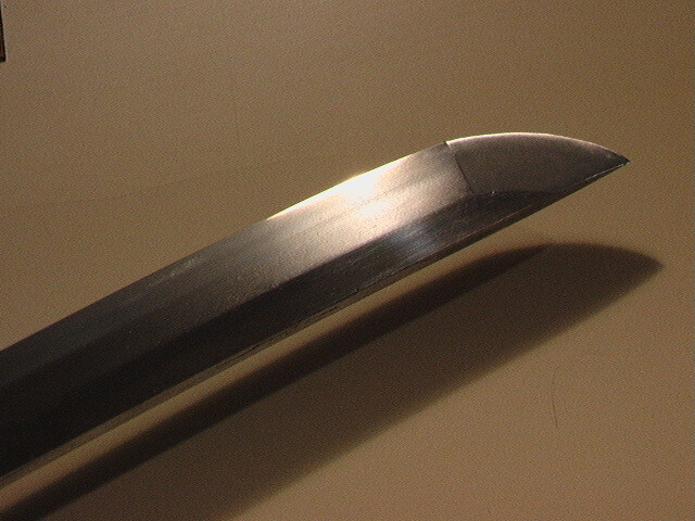

Hello everyone! I have been reading this forum for awhile (hopefully learning as I go) and decided to register to solicit some opinions and information.
I recently received a Nihonto from my Japanese wife's uncle. (when he heard about my interest in Nihonto he gave me one for a birthday present. Ya, I am too lucky.)
He told me it was by a swordsmith named Kunihiro. He mentioned that the smith was a second generation of Kunihiro. I have taken some pics and am hoping you knowledgeable people here can give me more information on the smith and the sword, if possible.
I look forward to your replies!
I apologize for the poor picture quality.

We lack data about your sword (over all length, nakago length, distance between the 2 mekugi ana) it seems it is O suriage, from the picture it looks like there is a high shinogi but I can be misraken by my eyes.
The Nakago colour seems to indicate a much older sword than WWII.
The Kanji uses for Kane is the on from Yamato school.
Kanenaga is a famous lineage of Tegai, one of the five Yamato schools
Refer to the following link :
http://www.nihonto.com/fwb8.html
For more information have a look at Bob Cole site (outstanding)
http://www.sho-shin.com/yam8.htm

I can't really figure out the hamon, it appears very straight, and I can't get a good picture.

Dear Unknown,
I would place this sword late Tegai sue Koto, some distinct features belonging to Yamato : High shinogi, Nie deki suguha.
Nevertheless, We have no idea of the kitae which is a stong kantei point, we have no indication on the hamon, but the hamon should be hoso suguha or it is almost hirosuguha. Futhermore the hamon should be O midare with more nioi than nie and very tight.
But as Nihonto as was saying late Jim Kurrash is full of exception, I'll stick to sue Tegai (based on the Nakago and the rust).
The sword seems very healthy from the kissaki picture, but (probably too much drink) I see as a small hamon line 5 mm under the marked one.
Just to add to Jean's comments-
There are several forms of the character we call "Kane". The form you have on your sword is most commonly associated with Yamato work, though definitely not exclusive to it. Many of the Yamato smiths would move elsewhere in Japan and set up shop. Many of them moved to Mino and changed the "Kane" they used to another form.
So, depending on the version of the 'Kane' character and supporting evidence like Jean used, you can get a good ballpark guess. More photos would help- but my initial impression is the same as Jean's.
