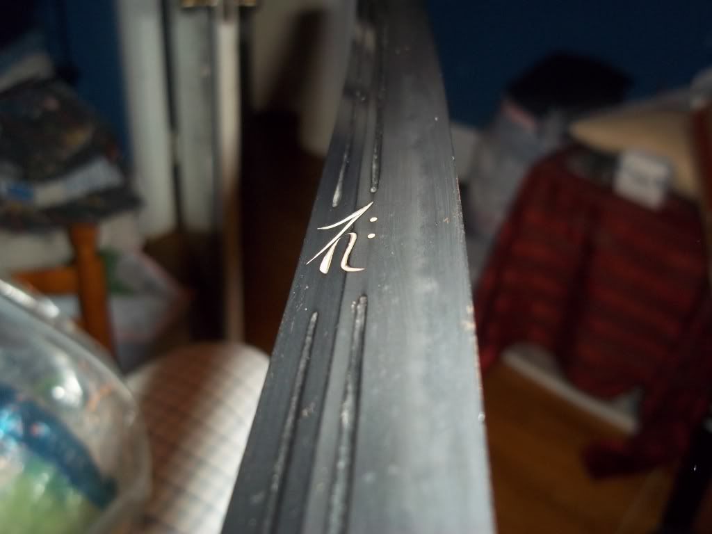

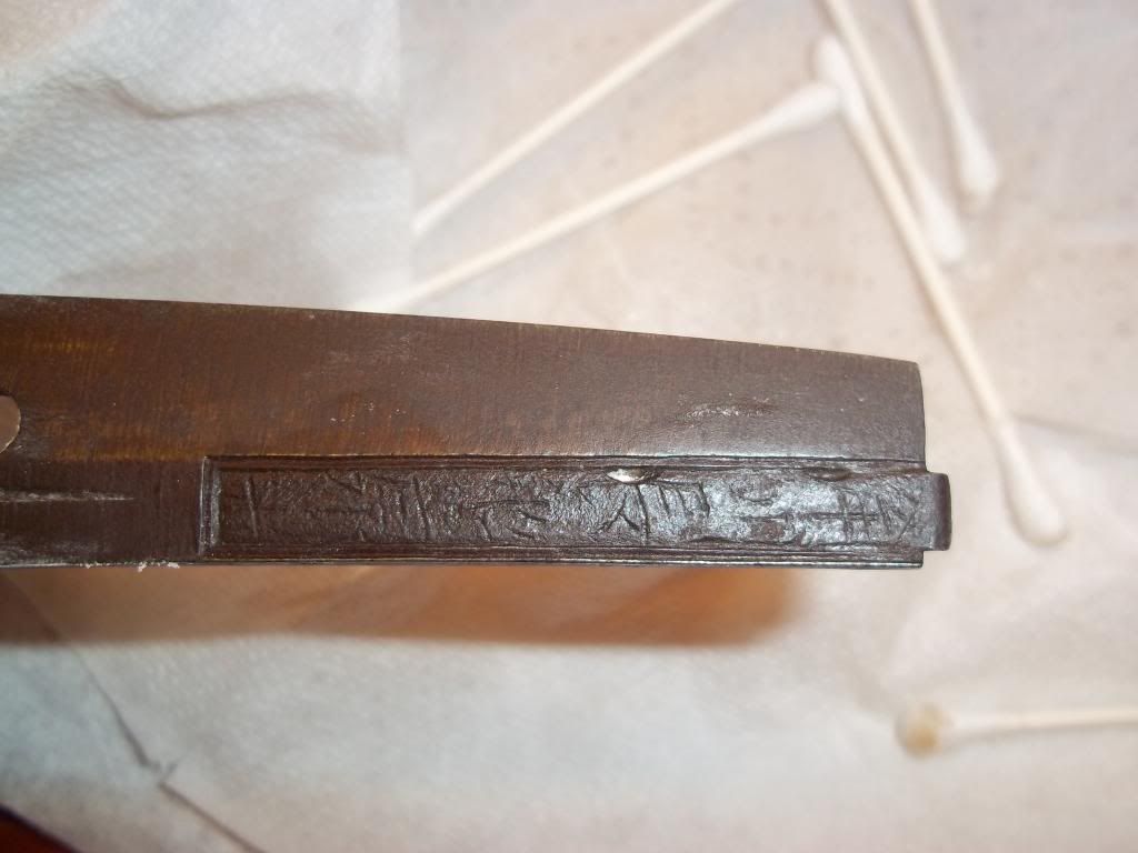

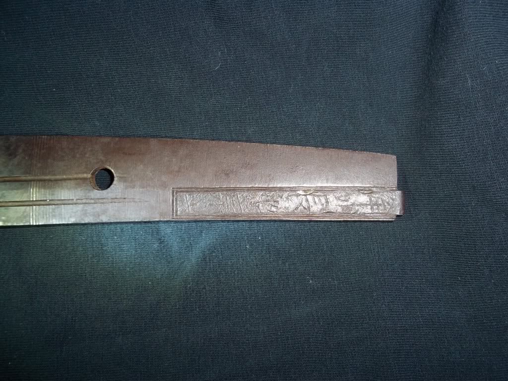

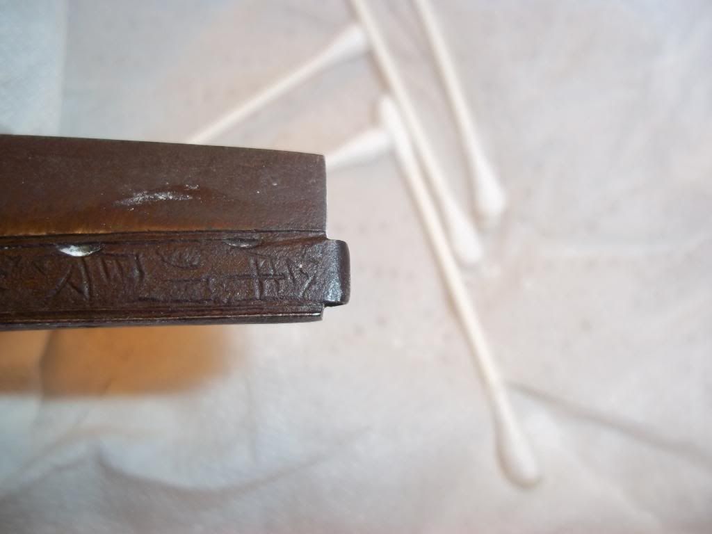

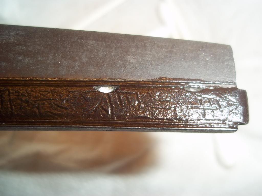

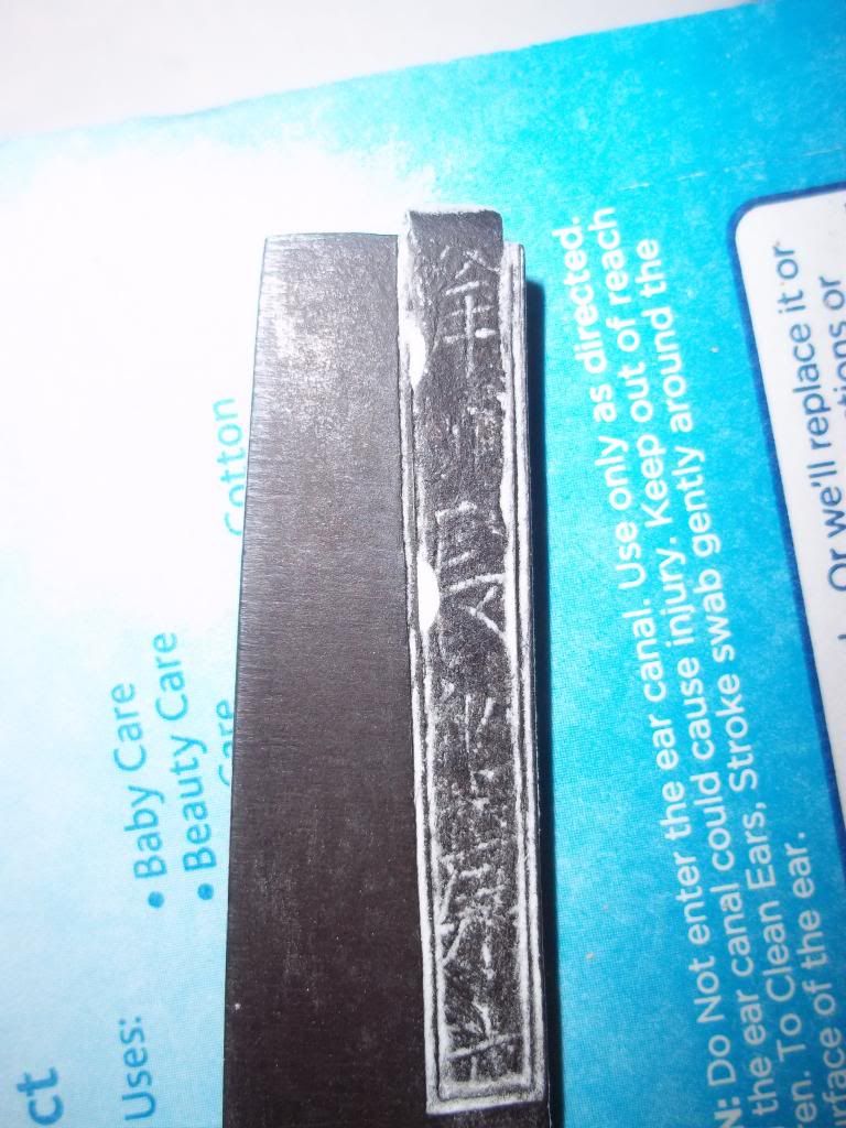

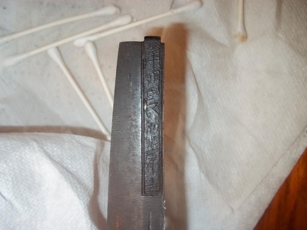

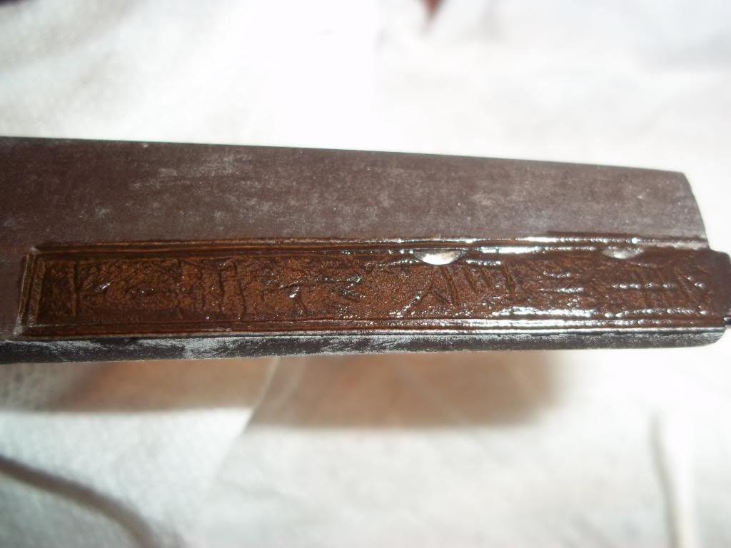

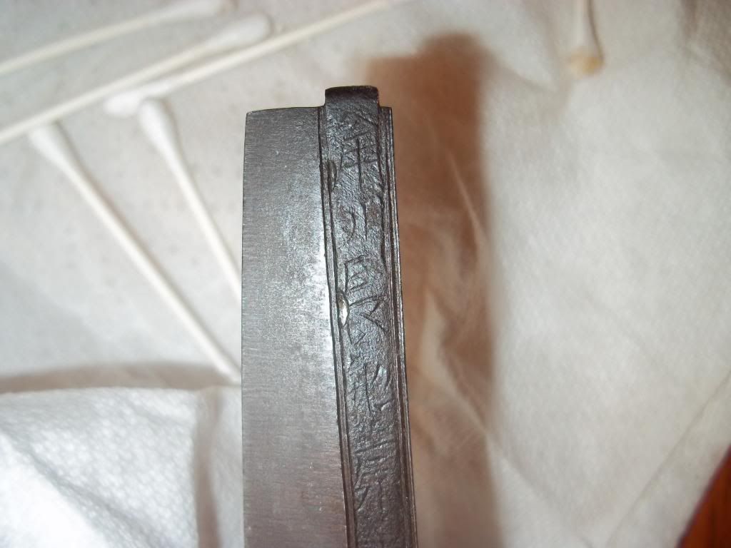

jason_mazzy Posted December 20, 2012 Report Share Posted December 20, 2012 This is a saved mei in the Orikaeshi Mei setup. It is well worn. I will attach several pictures and an album link. Your assistance would be very appreciated. Link to comment Share on other sites More sharing options...
jason_mazzy Posted December 20, 2012 Author Report Share Posted December 20, 2012 Link to comment Share on other sites More sharing options...

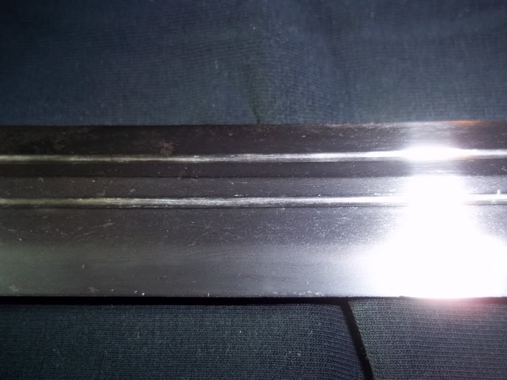

jason_mazzy Posted December 20, 2012 Author Report Share Posted December 20, 2012 http://s262.photobucket.com/albums/ii82 ... /Japanese/ above linkis to the album. I tried getting individual kanji. Then\se are tough, but someone thought enough about em to keep em. Link to comment Share on other sites More sharing options...

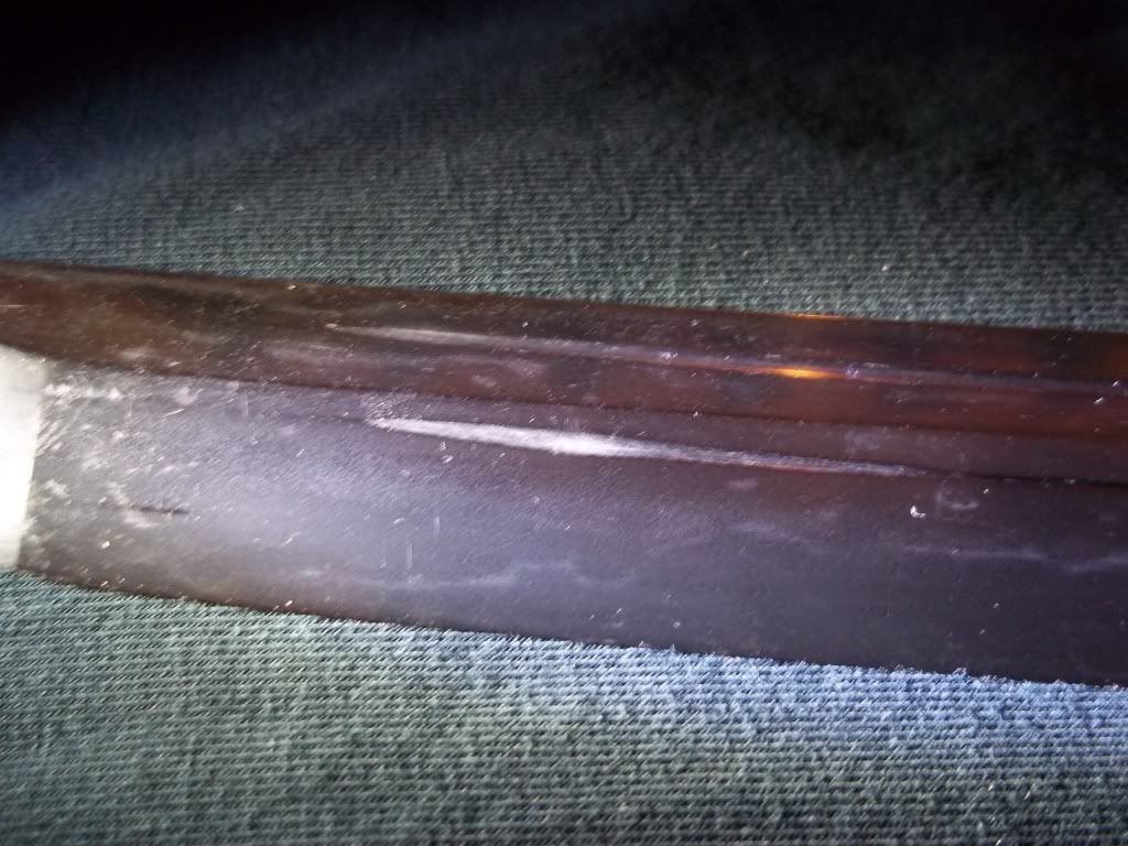

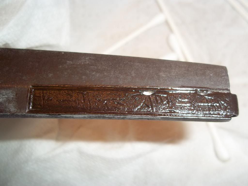

Bugyotsuji Posted December 20, 2012 Report Share Posted December 20, 2012 Looks like 備州長船 宗吉 to me. Link to comment Share on other sites More sharing options...
Nobody Posted December 20, 2012 Report Share Posted December 20, 2012 I think that the mei reads Bishu Osafune Yasumitsu (備州長舩康光). Link to comment Share on other sites More sharing options...
Grey Doffin Posted December 20, 2012 Report Share Posted December 20, 2012 I also think Yasumitsu. Grey Link to comment Share on other sites More sharing options...

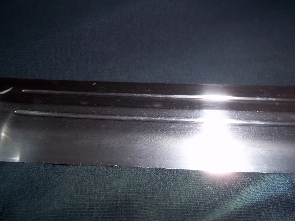

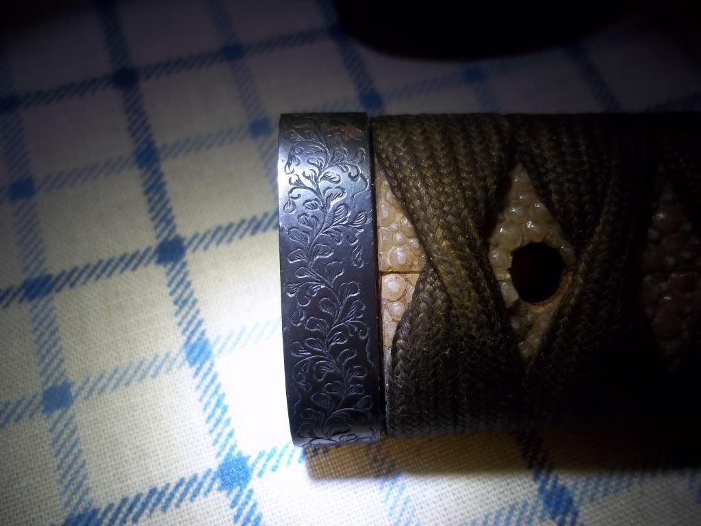

Bugyotsuji Posted December 20, 2012 Report Share Posted December 20, 2012 OK, I'll go with that. I was looking at pic 3 only! Link to comment Share on other sites More sharing options...

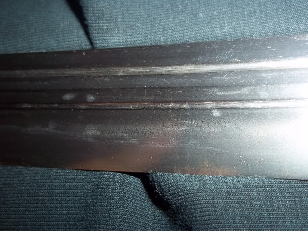

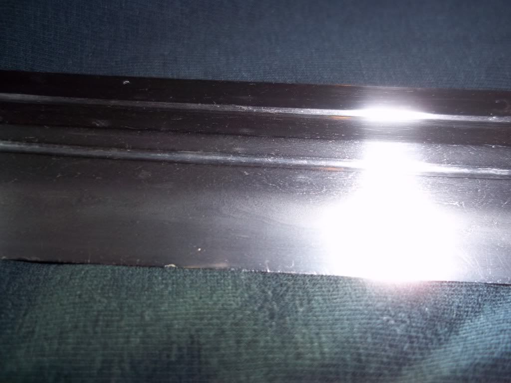

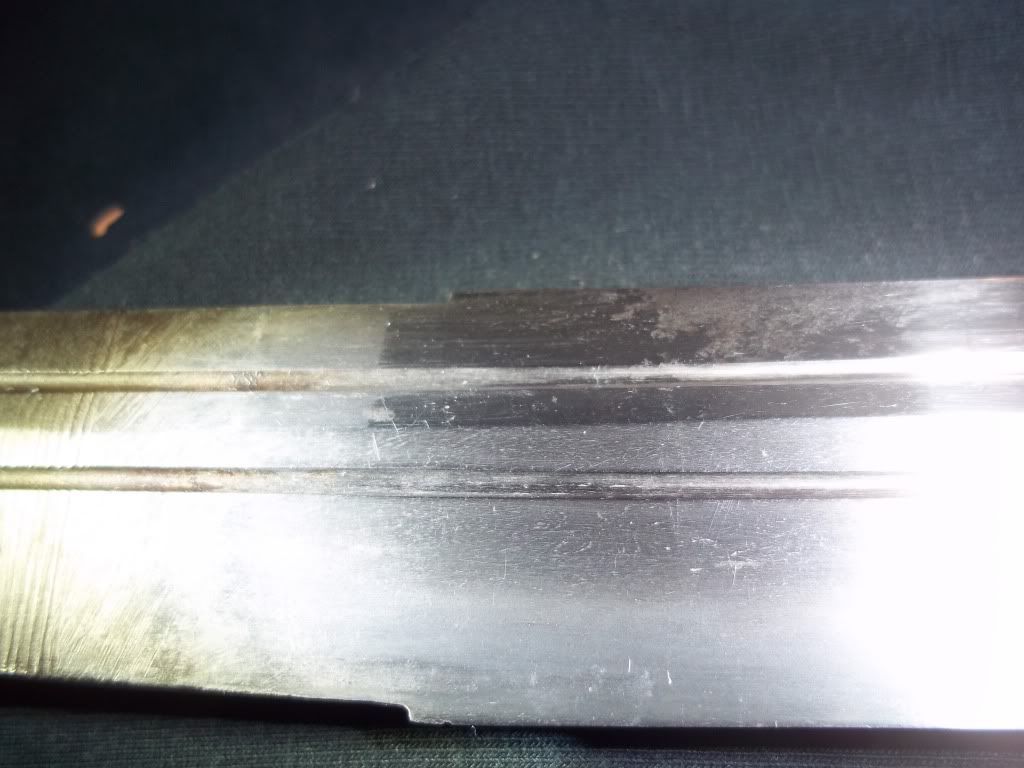

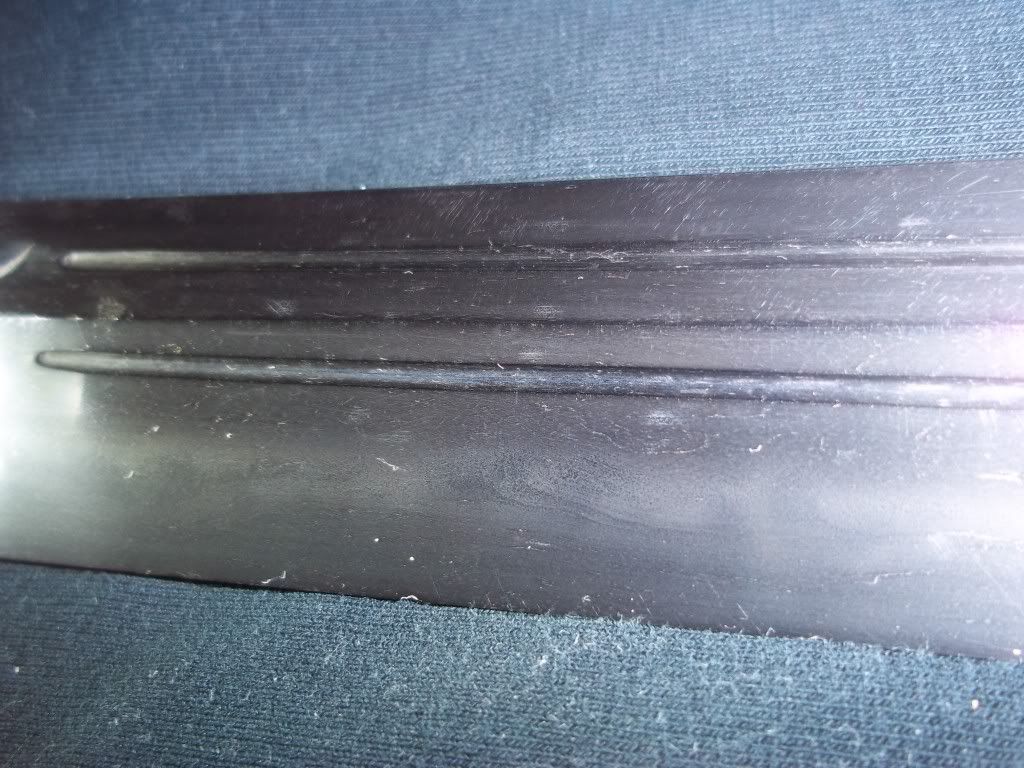

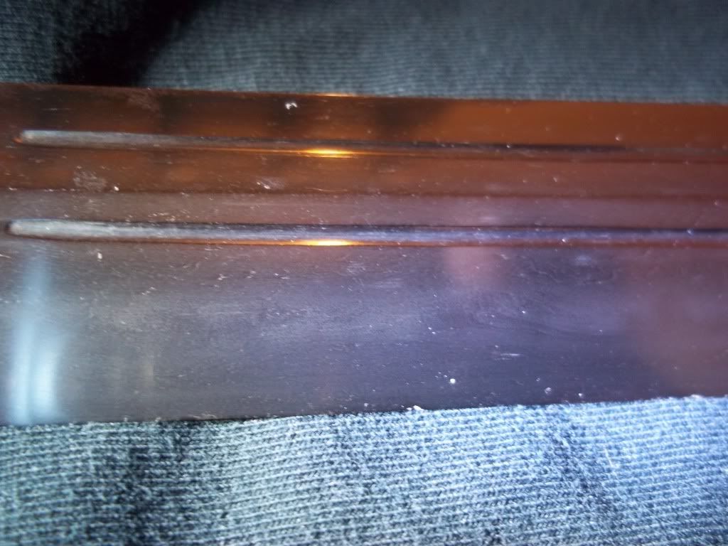

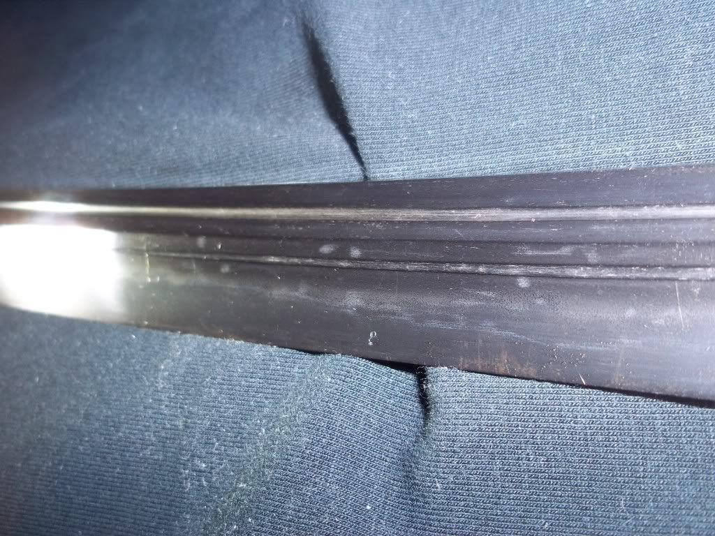

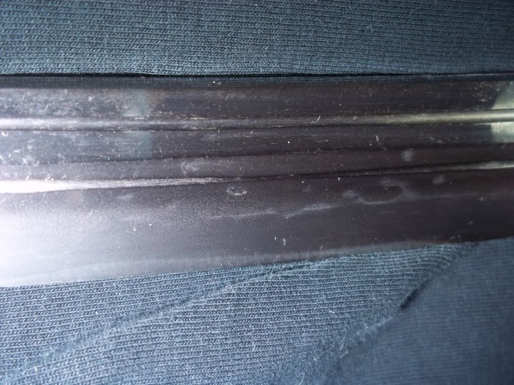

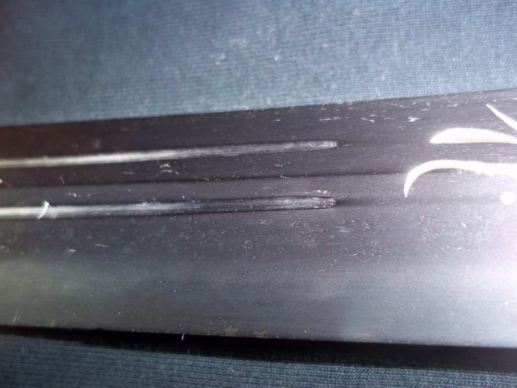

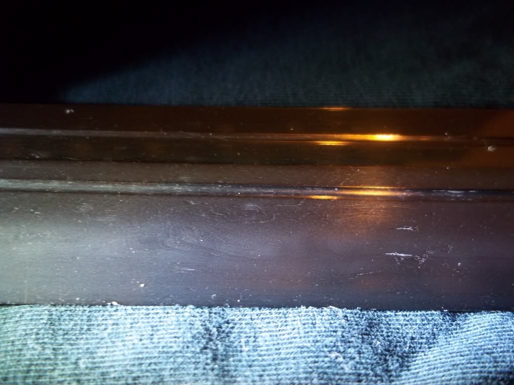

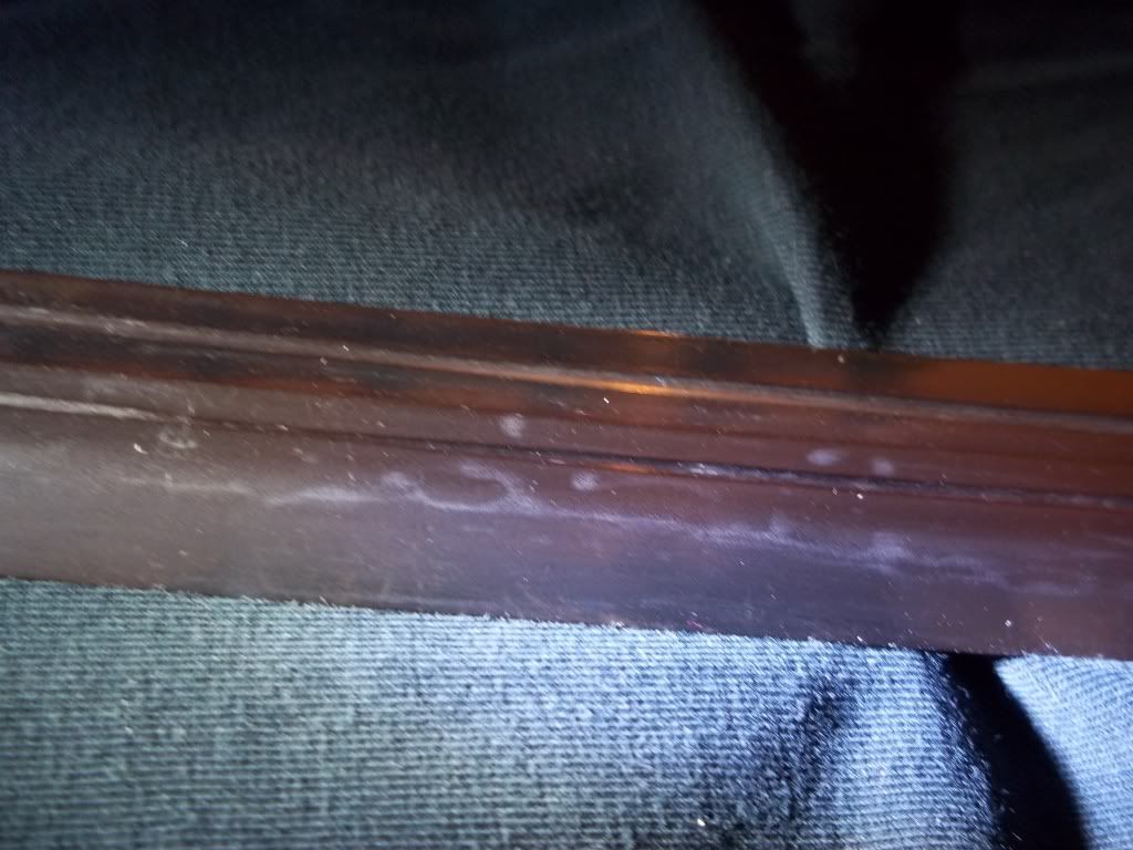

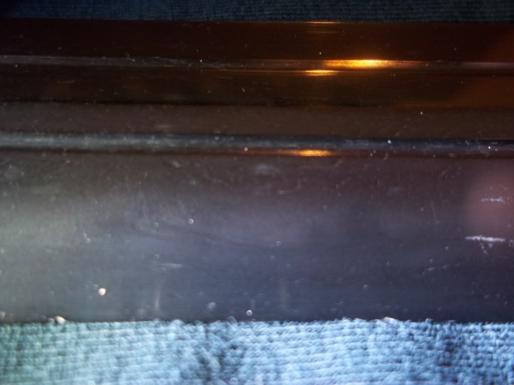

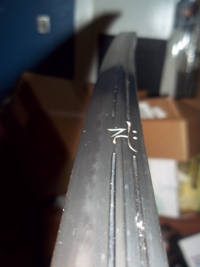

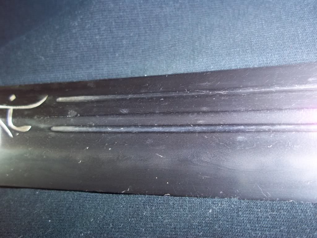

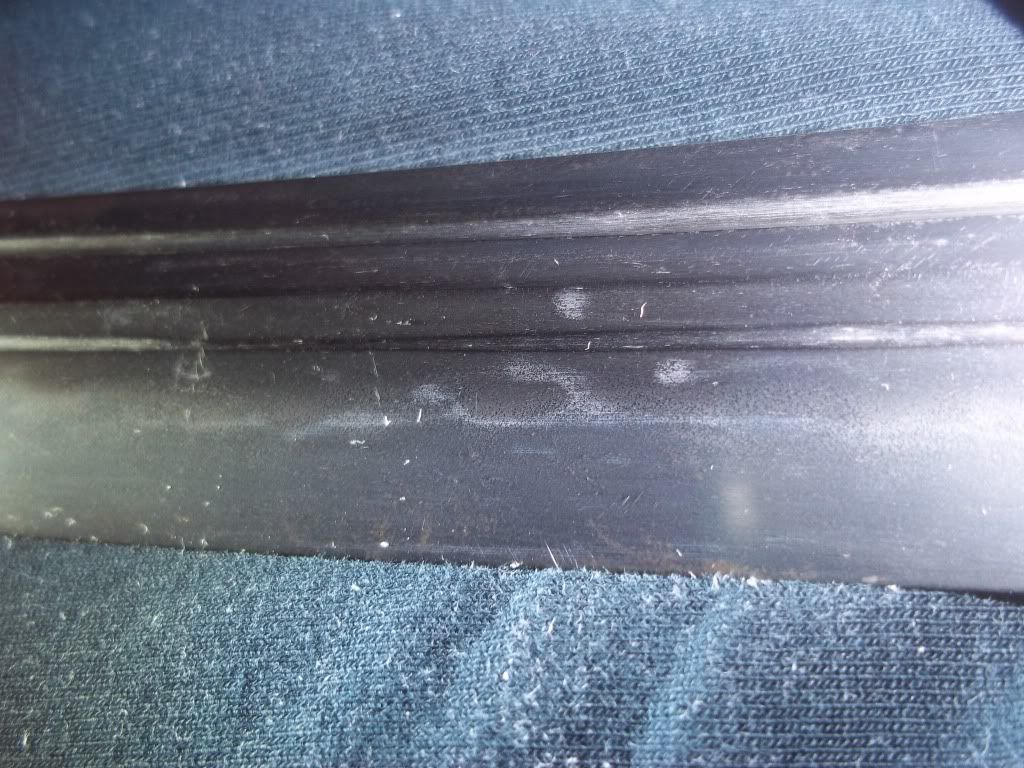

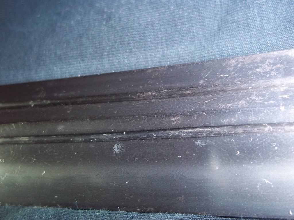

jason_mazzy Posted December 20, 2012 Author Report Share Posted December 20, 2012 it has double bo hi (soe hi?) and a kanji hormino on bothsides in the midle. Lots of nioie in the hamon kinda cloudy and has these little swirls above the hamon. Link to comment Share on other sites More sharing options...

jason_mazzy Posted December 20, 2012 Author Report Share Posted December 20, 2012 Tank all of you for your assistance. I don't know how you got it so fast. I have the sword in hand and I cannot even find all the kanji. You guys are amazing. Link to comment Share on other sites More sharing options...

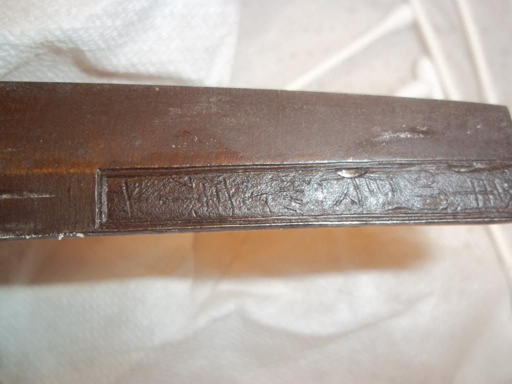

Jacques D. Posted December 20, 2012 Report Share Posted December 20, 2012 Hi, Many things seem odd on that sword, is it possible to see a picture of the whole nakago including machi ? Link to comment Share on other sites More sharing options...

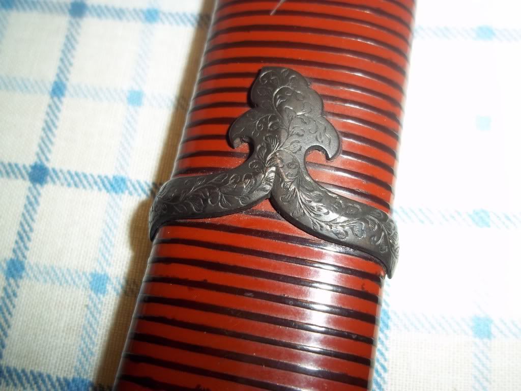

jason_mazzy Posted December 20, 2012 Author Report Share Posted December 20, 2012 now its a chinese copy? hrmmmmmmmmmm I assure you it is nihonto. Pictures forthcoming............. though I wasnt even trying to go this direction until I could study it myself. Link to comment Share on other sites More sharing options...

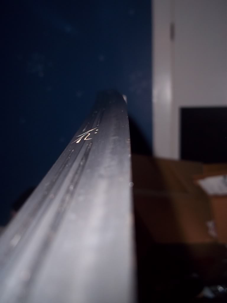

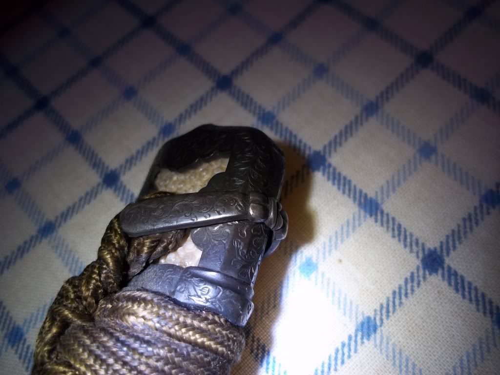

jason_mazzy Posted December 20, 2012 Author Report Share Posted December 20, 2012 My initial interest was in the koshirae as a potential daisho-ish project as i have another that is close. As will be seen the blade needs a polish. In the dark with a bright light I can see the jigane and activity, near impossible to capture with a camera so I apologize for the crappy photos. The blade has seen many many polishes but has surprisingly few loose grain or kitae. Link to comment Share on other sites More sharing options...

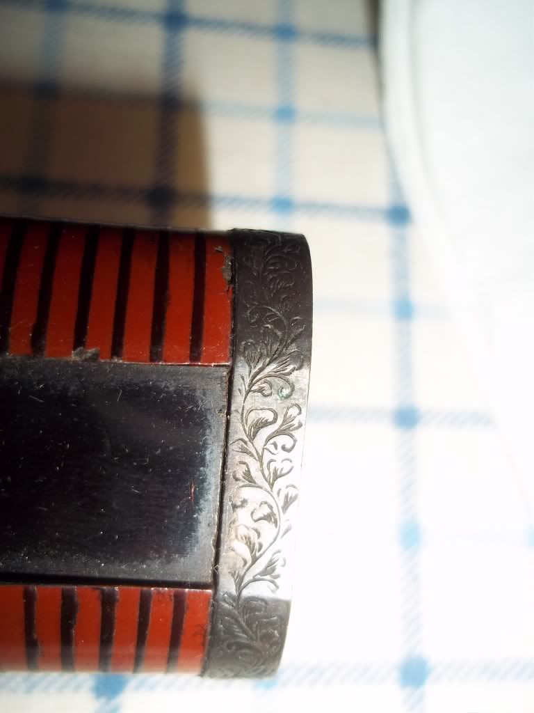

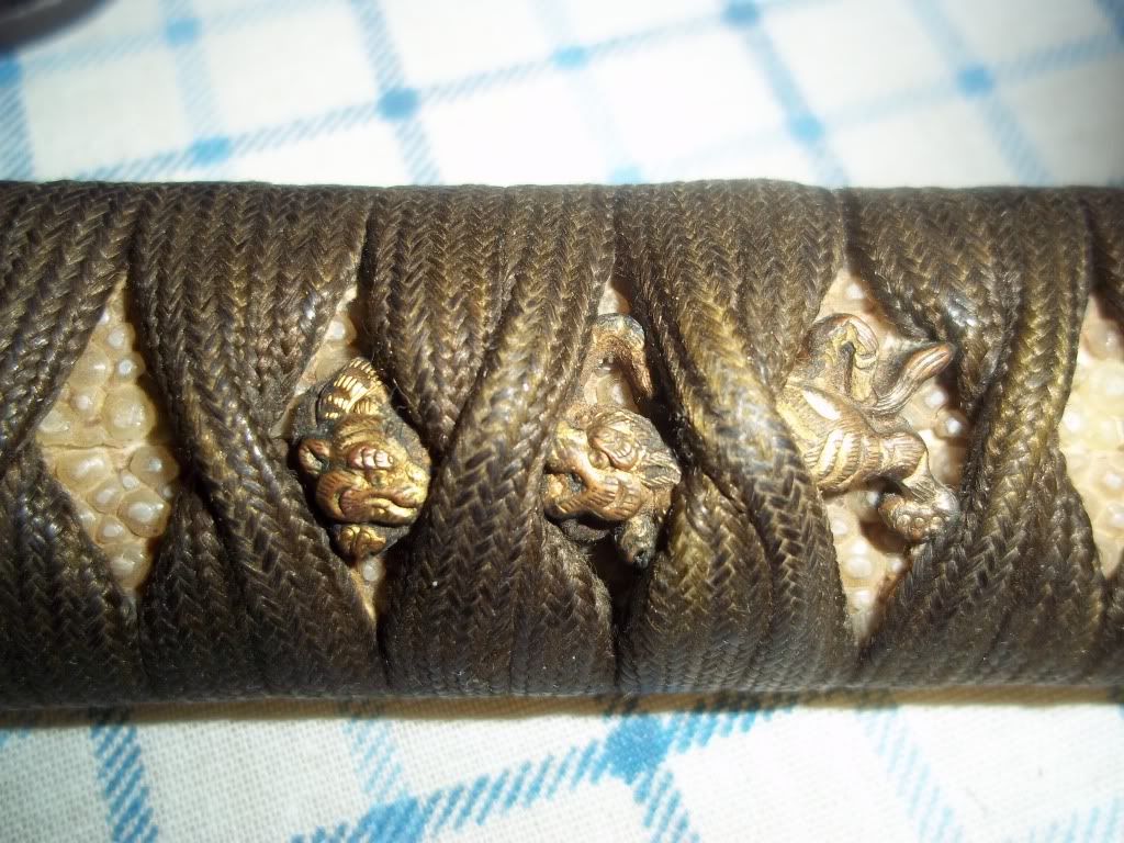

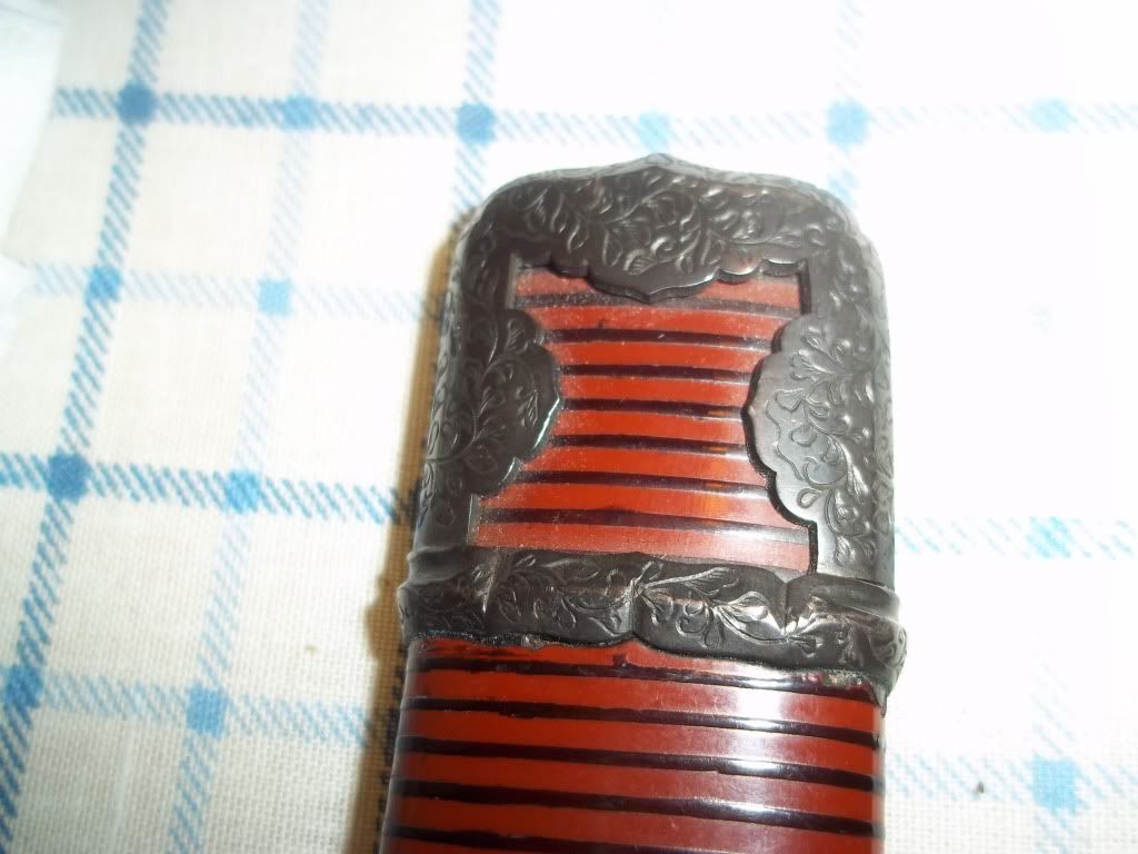

John A Stuart Posted December 20, 2012 Report Share Posted December 20, 2012 Martin, what do you mean by 中国 偽 期間 ?? China wrong period?? Not Chinese and how is it simulating another period? Great koshirae BTW. I've always liked handachi. John Link to comment Share on other sites More sharing options...

Jean Posted December 21, 2012 Report Share Posted December 21, 2012 Real one, but not Yasumitsu, wrong nioi guchi, do not see Oei Jigane in the shinogi ji. Link to comment Share on other sites More sharing options...
jason_mazzy Posted December 21, 2012 Author Report Share Posted December 21, 2012 Martin if you go to the album link there should be a kisaki photo. I cannot capture the Boshi well but I assure you it is there. Edit: iPhone autocorrect is does not like Japanese terms Link to comment Share on other sites More sharing options...
Jacques D. Posted December 21, 2012 Report Share Posted December 21, 2012 Hi, Very likely gimei. Jean About Oei jigane, Yasumitsu made different styles of jigane. Another orikaeshimei (this one is well done) http://www.tokka.biz/sword/yasumitsu2.html Link to comment Share on other sites More sharing options...
Jean Posted December 21, 2012 Report Share Posted December 21, 2012 Rule of thumb: Study the work look at the mei restudy the work ttp://www.nihonto.com/abtartshodaiyasumitsu.html If you refer to the jigane, have a look at the article here above, to the Nihonto Koza and to Yamanaka letters. Your example provided Jacques is classical of Bizen Oei as well in jihada as in hamon The more important thing is that the jitetsu is fine and goes from the hira ji to the shinogi ji and that the hamon is nioi deki. Two kinds of Hamon in Yasumitsu, koshi no Hira ita mixed with Gunome choji or suguha, in all cases nioi deki. This blade is not nioi deki, and there are long sunagashi you won't find in Yasumitsu (have a look at the hamon pictures provided) futhermore, in Yasumitsu work, the nioi line (nioi guchi) tends to be of the same width throughout the hamon, very controlled very far from this blade. Take your example, look at the nioi guchi: tight, equal throughout the blade very skillfull and controlled. Nothing to do with this blade. Link to comment Share on other sites More sharing options...
