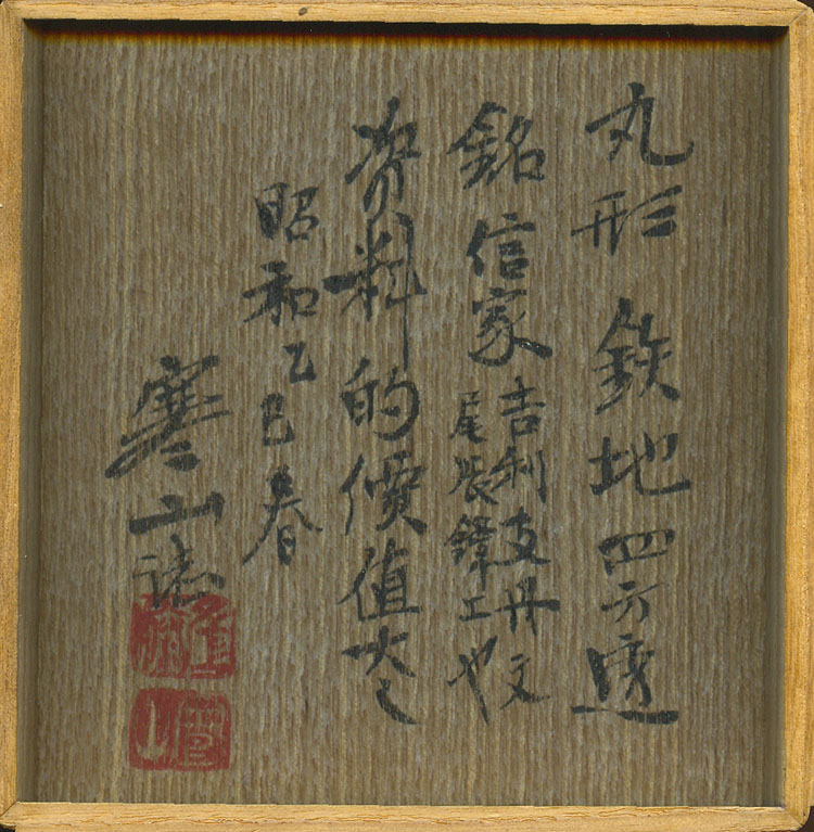

Hi Bob, without attempting to translate the hakogaki, I think this may be a forgery of Kanzan Sato's writing. 2 things lead me to this conclusion.
1: I have heard from very good sources that anything with a seal or Hanko is almost certainly a forgery. Sato may never have used a seal on his signature. Just a Kao.
2: This looks very new to me, the ink is new as is the seal. Plus the box looks very new as well. Considering the date is a Showa date (I think Showa 45 or 1970) I do not think that box is that old.
Also Sato's brush stokes look to have age, or like they are a little thin and they are very fluid.
This is not a very big example but this image on Ricecracker looks like typical Sato Hakogaki.
http://www.ricecracker.com/inventory/item593_menuki_botan/item-m-3-omori-botan-748%20copy.jpg
I could be wrong but it is my gut feeling.
Cheers
Rich

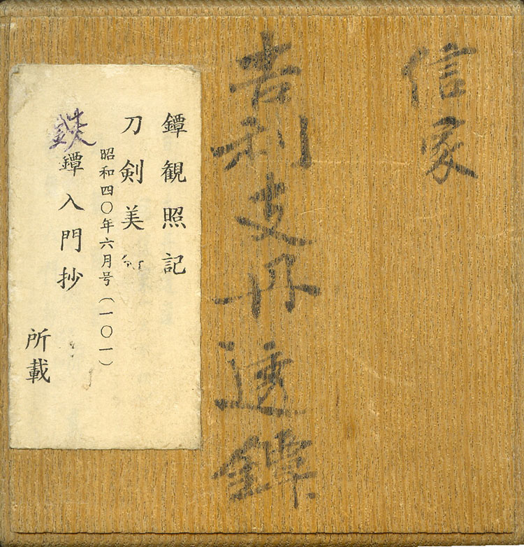

This is an example of a known hako gaki by Kansan Sato with hanko. However -- there seem to be quite a few forgeries out there so be careful about using the hako gaki as a reference to quality or authenticity. It's good to remember that most of these were done before the various meikan were published with agreed upon reference mei so these boxes fall back to the era where the item &/or mei was judged by appearance and memory of other examples, often from the viewpoint of the judges teacher(s). Torigoye and Sasano also did many of these. It is interesting that with the advent of origami from certifying organizations these have pretty much ceased to be done. I have to wonder if with all the disparaging remarks made these days toward these older generation experts writings few of the current experts wish to put their heads on the chopping block for future generations of researchers?
certainly appears to be genuine and would dispel the idea that Sato NEVER did hakogaki, but I think the felling of very new sumie still sticks with me, this box looks just too new.
Pete also touches on an interesting point. Many people do question the great old and past scholars and there are accusations of sayagaki and hakogaki being written for favour, and claims of just bad judgement and simple mistakes. I have a hakogaki by Dr. Torigoye that is for 3 fuchi, on the front of the box it says 3 Kashira.
Now questioning is good when in the quest for learning and if new information is at hand, but I think many dismiss the older guys just out of hand, and write off any learnings they may have had. We have books and the internet to help us today, they had the luxury of looking at thousands of items in hand over many many years.
I think the point of new scholars being scared off seems legit as well and as I believe there are several forgeries of Dr. Tanobe's sayagaki getting around these days.
I guess it makes it tough for everyone, both teachers and students. Who ever said this was meant to be easy ?.
Rich

While the mei you've posted looks very nice indeed and I second Stevens appeal to" see it all", I have to agree with Rich (T) with regard to the hakogaki. The box is undoubtedly far too new and the ink is also far too clean and fresh. Smudged seals, particularly in such a garish red are always very suspect in my book. And finally, if you compare the style of brush work with the example that Pete Klein was good enough to share with us, they are demonstrably quite different. Taking the other factors, I mentioned, into account we must assume that Pete's one is the genuine one.
This, of course, in no way means that the tsuba your hakogaki describes is in any way inferior or suspect in it's own right.
that's my opinion, for what it's worth.
cheers, Ford
