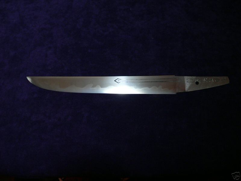

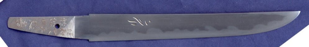

Hi i have avery nice gendai tanto signed ENJYU TAROH NOBUSHIGE. i have some scetchy information about him ,i beleve he made a sword for the emporer in 1949 and was expert in making JYUMONJI-YARI other that that i know very little,if any one can add to this i would be grateful
thanks Anthony

It has a very lovely & interesting hamon, Anthony. I hope that someone can make a positive identification of the smith, because I'd love to find a tanto just like it! If that's a kitchen knife, I want a whole set!!
Can you please tell me where you found &/or bought it? And the approximate price? Thanks!

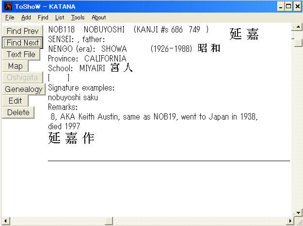

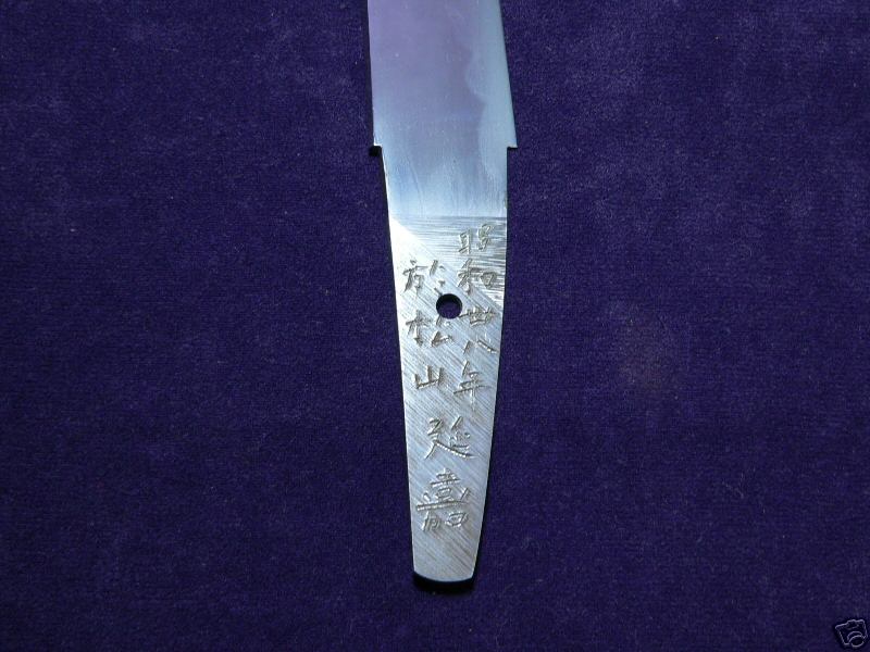

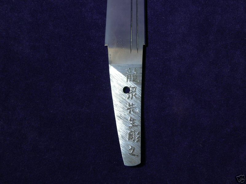

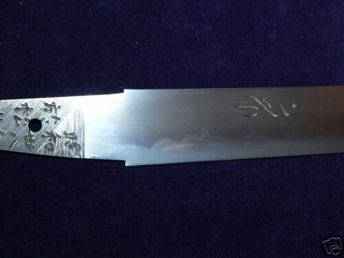

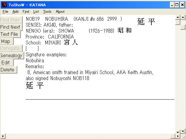

The smith's name on the nakago is Nobuyoshi (延嘉).

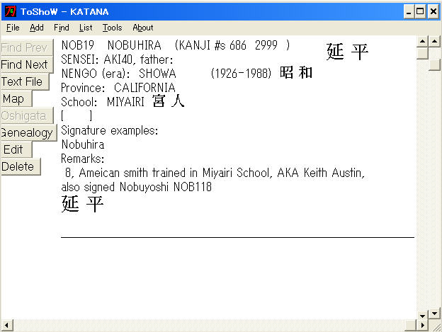

Thanks to ToShoW, I found who Nobuyoshi (延嘉) is. :idea:
He is late Keith Austin. His another mei was Nobuhira (延平).
http://www.ncjsc.org/article_keith_austin.htm
(He came to Japan in 1961. Its year of the database for Nobuyoshi saying 1938 must be a typo.)

What is the full translation of the nakago, both sides?
Omote:
Ryusen sensei horu kore (龍泉先生彫之) = Ryusen sensei carved this.
Ura:
Showa san-ju hachi nen (昭和丗八年) = 1963
Oite Matsuyama (於松山) = at Matsuyama
Nobuyoshi (延嘉)
Not trying to put words into Andreas' mouth, but I think he was joking about this Tanto looking somehow like a hocho ("kitchen knife") Masamune Utsushimono - at least that was my ininitial impression.

I remember seeing this tanto on ebay, it didn't sell for much more than $1000 I think.
Well done Anthony you got a good bargain :D

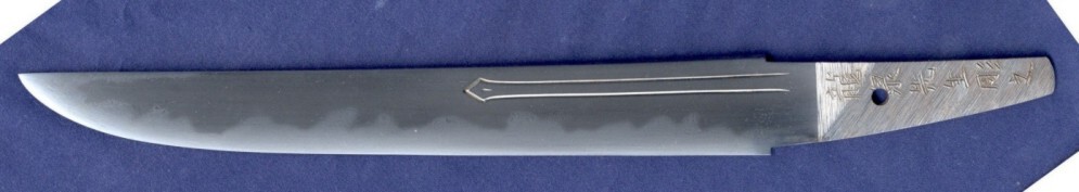

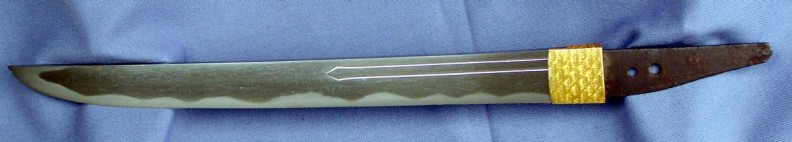

i would like to thank al the members for their input i could never have imagined t would have turned out so interesting.i paid $1500 for the tanto ,it was on ebay http://cgi.ebay.com/ws/eBayISAPI.dll?Vi ... &rd=1&rd=1 it was in fact a post by Peter in which he highligted 3or 4 tantos that maybe of interest so i have him to thank ,i have posted afew more photos.Thanks again

It seems that "Ryusen sensei (teacher 龍泉)" who carved the Horimono was Takahashi Sadatsugu (高橋貞次) himself. He had been the teacher of Keith Austin and was a living national treasure.
According to the info on the web page below, Takahashi Sadatsugu inscribed his mei as follows;
"高橋貞次作", "龍王子源貞次", "真鍛龍泉貞次造", "龍泉入道貞次造", etc.

I am indeed fortunate to own the blade ,the book you refer to is to be published and there are plans being made( Stephen one of the board members in U.S.A) is organising plans to get the blade photographed and then if the blade is definatley Keith Austin published in the book.

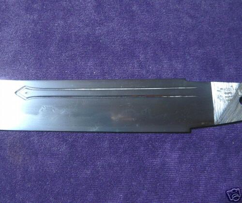

We all believe that based on the pictures, this could be the work of Keith Austin, however this was done earlier when he was working with Takahashi Sadatsugu, just before Takahashi became ill. Keith signed Nobuyoshi at this time......Keith then went to finish off his apprenticeship with Miyairi Akihira and his name was changed to Nobuhira. Again this is all based on the pictures, and not actual in-hand study....
Keith completed his apprenticeship and obtained his sword smiths license in 1971.
Though the style of this tanto is different that we we have seen in most of his existing work, we are in agree that this maybe due to the style he was taught from Takahashi.....vs. what style he was taught by Miyairi......
We are still very interested in getting some high quality pictures of the tanto if possible. We would like to study the tanto as much as we can....

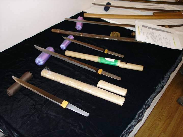

Three pieces of Nobuhira's latest works (two tanto and 1 wakizashi)
