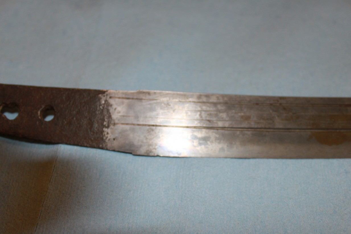

a lot of books help understand how the shape of a sword changed through time. If Kamakura you would expect it to be smaller/shorter and uchizori or no sori, big wide blades, sort of like this were made in nambukcho but they would be thinner and have little sori, so by process of elimination you can say it is Muromachi as there were a blades of this shape made then
From the pictures it looks like it might hira zukuri (flat on both sides) or kata kiriha zukuri ? (Flat on one side with ridge following along the cutting edge)
1st pic, there appears to be glare off one of the lines cut in a horimono of a ken instead of a shinogi.
2nd pic, the light makes that side look like the shinogi follows along the edge?
http://meiboku.info/guide/form/zukuri/index.htm

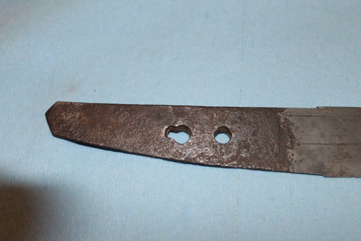

I don't see any ridge in the nakago, so I'd guess the shape was one of the two mentioned above, any sword that has a shinogi usually follows all the way through the to the end of the tang, probably need clearer pictures.
In fact wakizashi with a shinogi didn't exist before the early Muromachi. Wakizahi even uchigatana were found in Kamakura era but they are hira-zukuri.

Have a look at the second picture.
Hello Jacques,
What should I be looking at? The only thing I see after copying and zooming in on the picture in photo editing software is a worn ken horimono on a blade that looks to hira zukuri on that side?
(I do agree with not planning on a polish, especially considering the photo quality isn't really a basis to evaluate such an investment on)

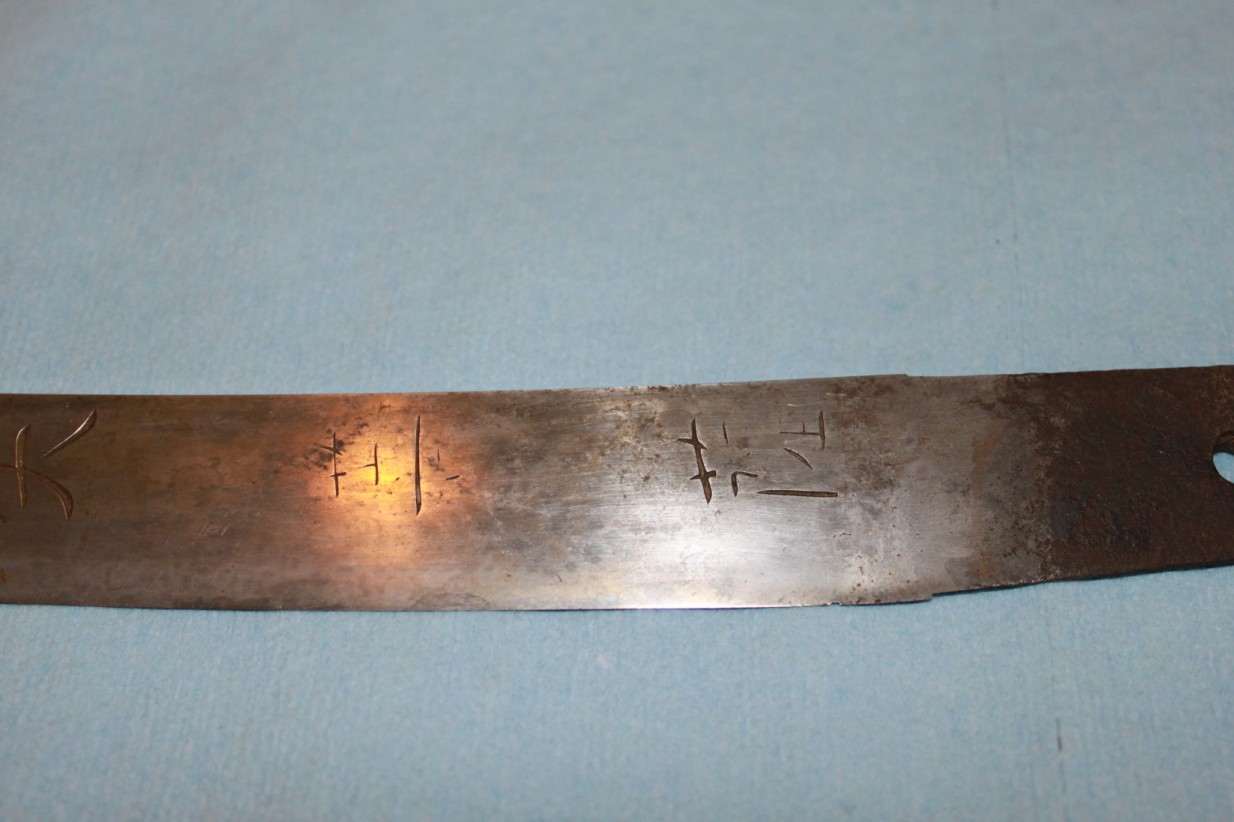

If you genetlmen have time, please look at the photos and let me know what you think.
It seems that the blade is actually Hira Zukuri, with a Mune Hikushi, and I think it is an Omaru Boshi.
IMHO, I kinda like the blade now that I get a closer look at it. It's a bit more ornate than I originally thought.
