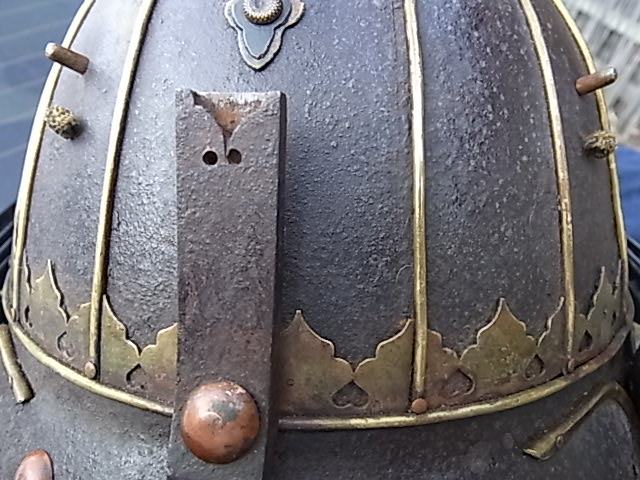

First impression: late muromachi Soshu Myochin.
but, the shiten no byo aren't on the same plates left and right front??

Really bizarre. Also, there seems to be too much space between the shiten no byo and the hibiki no ana. Maybe these were later additions?

Hey Justin,
If you look at the front view, you can see that the shiten no byo (the long protruding rivets) and the hibiki no ana (the holes underneath the shiten no byo) are not on the same corresponding plates from the front central plate (i.e. they don't mirror each other). No self-respecting Japanese armourer would ever do that. Also, the distance between the shiten no byo and the hibiki no ana seems too great - they're usually much closer together.

I think the hachi itself looks fine, but it's my suggestion that the shiten no byo and the hibiki no ana were added later. I can think of no other reason why they would not be located on the proper plates.
Perhaps Ian, Luc or some of the other experts may have a theory about this.
Whilst I think the hachi as such is fine (although it may have been lacquered originally) I do have a suspicion it has seen quite a few changes since its inception. To my eyes the peak and haraidate look as if they have been added. The haraidate in particular is too long to fit - positioning the large soft metal rivet being positioned up through the base of the helmet itself rather that through the koshimaki. Similarly the rivets on either side seem a little low unless the koshimaki is very deep over the brow. I also feel the raised edges to the shikoro plates and fukigayeshi are just a bit too prominent and the corners of the intermediate plates too rounded. Clearly the shikoro has been added - see the two soft-metal rivets behind the fukigayeshi instead of just one, the other two holes taking the loop for the helmet cord.

For anyone who does not understand the exact nature of this discussion, normally all parts of the kabuto would be symmetrical, in this case the two protruding rivets (shiten no byo) are not exactly opposite to each other, the one on the left has one plate between it and the center of the kabuto while the one on the right has two plates between it and the center, this is not something you would normally see on any kabuto. perhaps there was damage to the area that would have necessitated moving the location of the shiten no byo, if so then viewing the inside of the kabuto might show this, otherwise I can can not think of any reason for the miss matched spacing.
Shiten no byo: Vestigial rivets applied as decoration to helmets.
Hibiki no ana: Name of the four holes on some multiplate helmets below the shiten-no-byô. Holes in a helmet bowl originally for attaching a helmet cord but later decoration.
Haraidate:Tubular crest holder attached centrally to the peak of a helmet.

Since the hibiki no ana and the shiten no byo are essentially decorative, they could have just as well have been left off rather than being positioned in odd positions. The only use I have heard claimed for them was for a kind of 'rain cover' tied over the tehen kanamono through the loops of braid that are fitted through the hibiki no ana - I even have grave doubts about that. In my view they are just anachronistic survivors that were added because 'we have always done things that way' - like the ring at the back of most helmets that were originally for a jirushi but ending up being something to hang a decorative agemaki bow from.

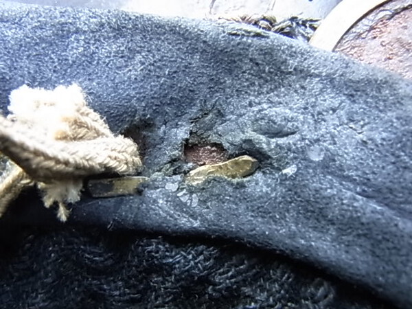

Hmmmm..... Almost everything is covered with leather, but you can just see a window of rust underneath in the following shots.

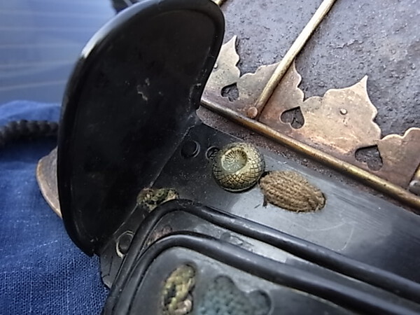

Try to imagine the camera angle where I have shot under/behind the Fukigaeshi, between the hachi and the Shikoro.
In an external shot you can see two small holes through the Higaki, indicating a previous life? I cannot see any evidence that it was once covered in lacquer, Ian, although the thought had also crossed my mind; I have tried to show the layers of packed rust behind the Higaki.
I have included a shot of the helmet from behind with the Shirushi hanging from the rear Kan.
Piers, Oh dear. As I suspected the shikoro is a modern fabrication. Where the fukigayeshi is riveted to the upper lame would, on an old shikoro, be levelled off with filler. Here the junction has been simply painted over. Again the bead around the plates of the shikoro are just too prominent and look wrong. I am also sorry to say I don't believe the shiten no byo. They would normally be iron not brass and would have a carefully rounded outer end, not the series of flats from either a file or the riveting. On a Muromachi helmet the fukurin covering the suji and the igaki (higaki?) at the base of each plate would be made as one unit. Here the igaki look separate from the fukurin. I'm sorry to have to say there has been considerable 'refurbishing' going on with this helmet.

Just for those who were following this thread about the odd Kabuto, I showed it to an expert today to get his immediate reactions. He completely backed up what you gentlemen suggested earlier. The decorations and fitments are all later, including the copper Byo and hachimanza. The Higaki should not be pointed like that, and the little studs holding it on are too obvious and wrong. Possibly the hachi is old and was once covered in Urushi, he conceded. He almost tore at the Ukebari with his fingers in frustration, needing to be able to see the inner surface, but it has been glued in so perfectly that it is almost impossible to peek behind.
