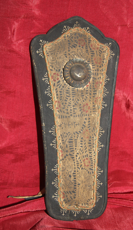

Hi guys!

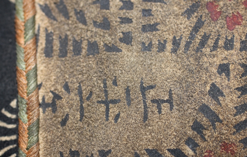

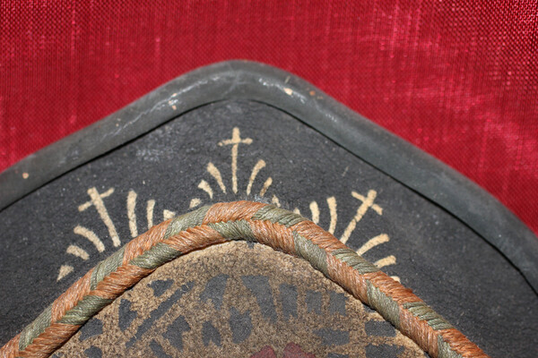

This thread was inspired by Anthonys thread about his new armour. Under the section "nicknacks" this single kyubi no ita, which I had for many years, pops up. Three things always interested me. 1. Age of course. I guess EDO-period always works. But any opinion to a more precise date? 2. The crosslike decoration. Is this a common design? I def get some catholic vibes. Which if true ads something something. 3. The "inscription" which after reading Ian´s reply on Anthonys thread, would be a licence date for the leather. Correct?
I guess this piece would have looked really nice from the beginning. Almost all of the gold decoration is gone. It´s actually a pretty heavy piece.
/Jan
Jan, I don't want to rain on your parade, but I'm afraid the Kyubi no ita isn't very old. The cross shapes are in fact shobu gawa - that is they are meant to be iris flowers with leaves each side. Traditionally this was made by clamping strips of wood with carved wooden stamps attached onto the leather wrapped around a drum. It was then dyed with indigo. Where the stamps pressed into the leather the dye was prevented from penetrating thus leaving the design in white on the blue ground. However, the dye did bleed under the stamp slightly giving the design a slightly fuzzy look. The leather on your kyubi no ita is too sharp and has been done with a stencil. I would guess Showa period.
Ian Bottomley

George, The date is that when the pattern of leather was licensed for production - Shohei period.

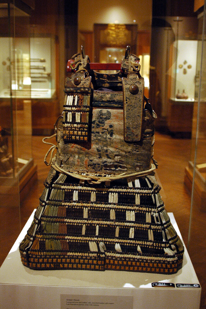

On the image of this o-yoroi you can see the sendan no ita on the left, and on the right is the kyubi-no-ita which I have seen translated as "dove tail plate".

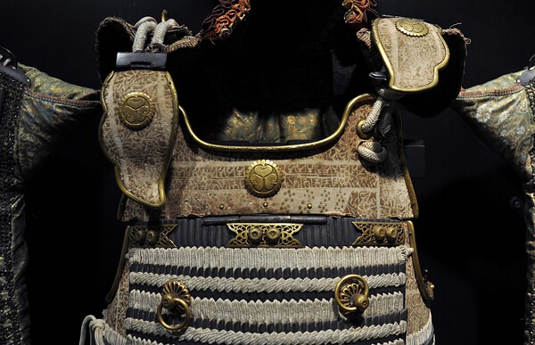

The next image shows how the sendan no ita and the kyubi-no-ita evolved into gyoyo.
